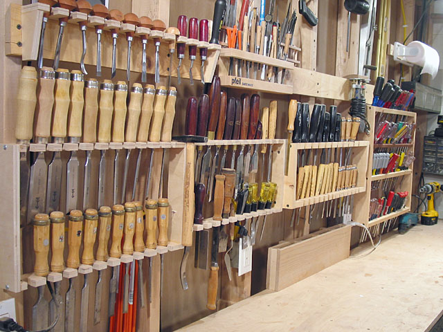

What sizes? Duh....as many as your wife will either approve or not notice!
Seriously, I would suggest having two or three each of the 1/2" and 3/4" (so you always have a sharp one), and then an 1/8" and a 1 1/4" or so.

Some guys like coins or stamps or baseball cards. I like chisels (and industrial robots).
John Watkins
